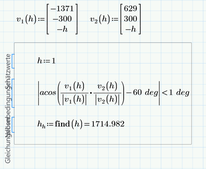

I get a "No Solution is found" from the find() in this solve block in Mathcad prime.  Can someone please tell me where I'm going wrong?  (code attached)
I have noticed that if i put the initial guess in for 'h' as the answer then the solve works but this defeats the object somewhat.
Thanks in advance!

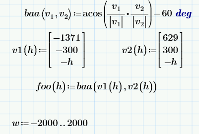

It helps to plot the function to see what is happening and why it cannot solve.
First write a function of "h" to plot.
Then plot the function foo.

The solve block works exactly the way you had set it up but you can't simply use v1 etc. in your constraint because these are already vectors with h=1 and not dependent on h anymore.
You have to define v1 and v2 as functions dependent on h (I prefer to do this outside of the solve block)

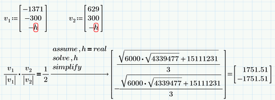

If you want to know the h for exactly 60 degree you may use the symbolic solve
