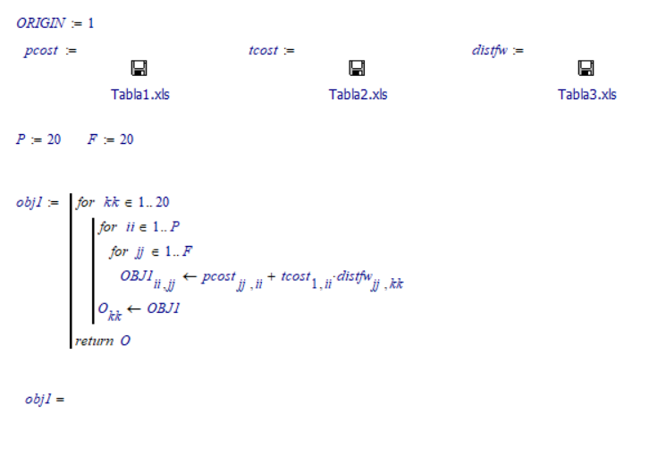

Can anybody to simplify this program?
I must run for “k” and “i” twenty times the block.

Hi Carlos,
should be as simple as embedding the two for loops in yet another for loop.
See if this is what you need.

Luc, the program does not return results.
See the attached image.
CarlosRomero
Luc had disabled autocalculation in his sheet.
So either turn it on again or Press F9 to force (a single) re-calculation of the sheet.
Thanks Luc and Werner.
It's OK.
