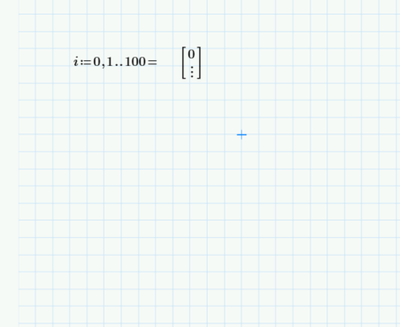

I have a column of values stored in the variable "i". My intent is, I want to utilize a while loop with a continue/break statement to track a specific range of numbers within the column based on a given input row index. For instance, if I input the row-index value of "4", I would like to extract the range of values from the 4th index of variable "i" until the end.

This is what the submatrix() function is made for - look it up in the help.
Your example: submatrix(i, 4, last(i), 0, 0)

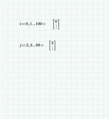

Thank you @Werner_E . your approach worked great and saves a lot of effort. I now have two single column matrices ("i" and "j") and would want them to be combined into a single column matrice. The condition would be in the new matrice, the first part will be filled with the values from "i" and immediately after that, the second part will be filled with the values from "j". Both matrices "i" and "j" will have arbitrary range of values . Please help.
Thats what the stack() function is made for!
new:=stack(i,j)
