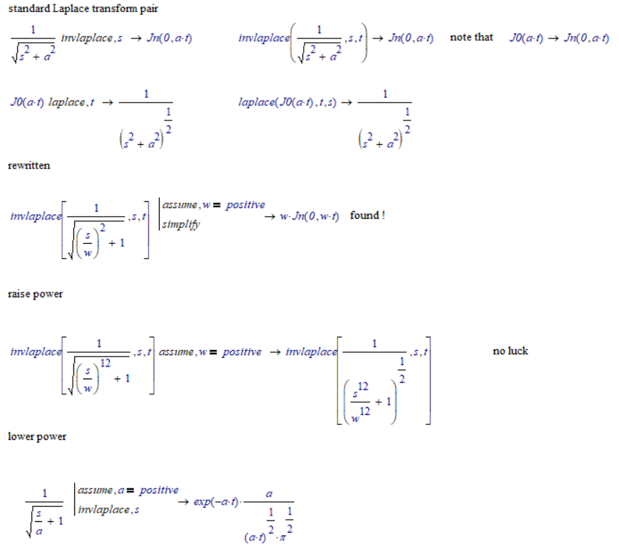

See the attached file. When I try invlaplace in Mathcad 15 with a simple s-function, it works, but with a slightly more complex function, it doesn't give a useful result:
I am a very infrequent user of Mathcad, so please bear with me if I ask stupid questions.
I do not understand the repeated 'invlaplace' and the 's,t' part of the result. I expected a function of t that I could plot after including the numerical value of omega. Setting t=35 and [omega] = 2*pi*t doesn't help.
I tried putting ', omega' after the first 'invlaplace',  but it produces no more useful result.
Í don't wish to spoil the fun, but the expression is its own magnitude:

The result means that Prime is not able to find a symbolic solution for the transform.
The "invlaplace(...)" you see at the RHS is just a function which normally is use internally by the symbolics to derive the inverse laplace.
Writing "omega" after "invlaplace"  is definitely wrong as thsi would be interpreted as that the variable in the transform domain, the complex freqency, is named omega in your function.
Default is that the complex frequence is "s" and the variable in the time domain is "t". If this is the case you don't need to provide any further modifyers to "invlaplace" but you sure can write "invlaplace,s,t".

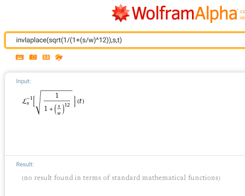

BTW, Wolram Alpha gives up on your function, too:

That Wolfram gives up, too, is even more surprising.
The 'more or less standard' would be 1/sqrt(a^2+s^2), the inverse Laplace transform of which is J0(a*t).
Mathcad (that is, version 11, using Maple as symbolic engine) transfoms this pair back and forth.
As shown, you could rewrite the Laplace transfomed as 1/sqrt(1+(s/w)^2), provided that w is positive, but that's still power 2, far from power 12.

I'm convinced that neither Mathcad, nor Matlab will give you the inverse Laplace tranform of the expression in s that you gave, based on the fact that Mathematica cannot give it and I didn't find it in my textbooks.

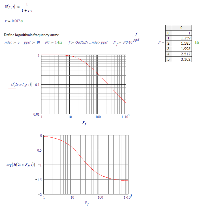

You are quite right. Invlaplace is not the right approach at all. What I want to do is to take an expression with s as the single variable and substitute omega*i  and then rationalize the result (i.e. convert the expression to an equivalent in real quantities) so that I can plot it. I think I have worked out teh syntax for using substitute, but I can't find anything about rationalization in the Help. Perhaps it's called something else
Maybe you are looking for this:
Note that mathcad 15 supports logspace() or so to define a log array.

To substitute s with omega*i is simple:
Please explain 'rationalization'...
