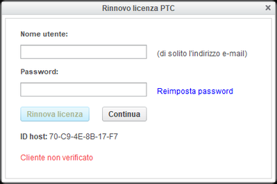

Hi!
my license for Creo Student 6.0 is expiring in a few days. Whenever I try to renew it, it says that my account is not verified.
I tried to rest the password several times, but the problem is always the same: customer not verified.
What could be the problem?
Kind regards,
Jacopo Magnani
cliente non verificato = Not verified customer

I don't have the ptcsetup file of CREO 6.0.2.0.
This is the screenshot:
Thanks in advance for your kind help.
Jacopo
"PTC Academic Program - Free Download Page": https://support.ptc.com/appserver/auth/it/esd/academicFree.jsp

try changing your password (as mentioned in https://community.ptc.com/t5/PTC-Education-Forum/License-renewal-issue-customer-not-verified/m-p/731070 discussion). Use ascii characters only in new password.
Also you can look at https://community.ptc.com/t5/PTC-Education-Forum/PTC-License-Renewal-Creo-4-0-quot-Customer-not-Verified-quot/m-p/588316
