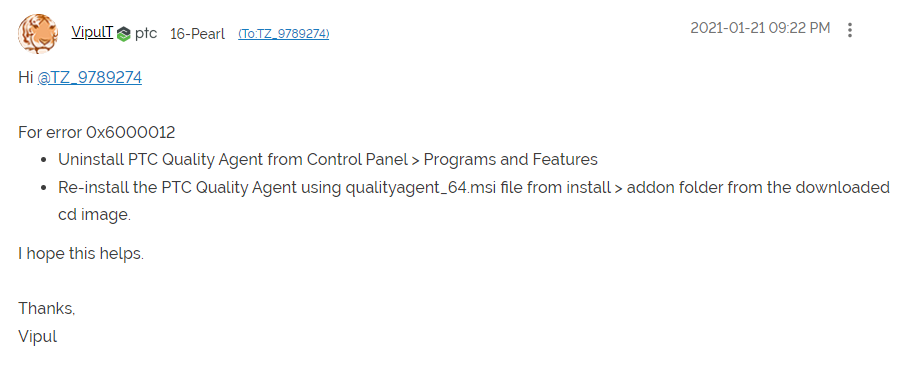

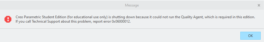

use search Community functionality ... enter 0x06000012 string and click Search button.

next time please invest more of your time in searching for an answer. If you're going to work with Creo, there's still a lot to learn.
https://community.ptc.com/t5/PTC-Education-Forum/Licensing-Error-Creo-7-0-2-0/m-p/708655

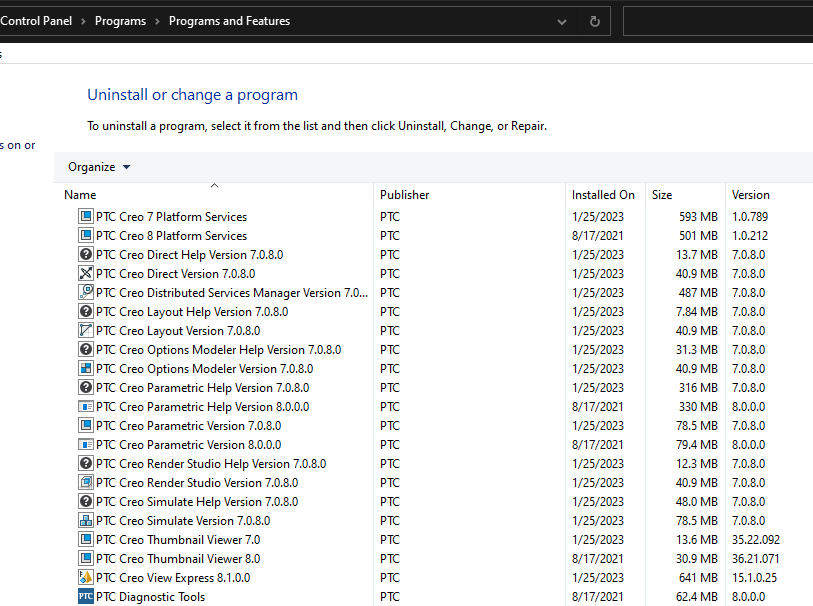

I do not see “PTC Quality Agent” in that location. Might it have anther name?
YES you are right ... uninstall PTC Diagnostic Tools item.
