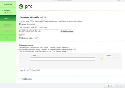

License Identification error!
AP_9697513
2-Explorer
I had some problems installing the program the first time so i reinstalled it but now im getting this error?
1 REPLY 1
I'm assuming that you are licensing Creo 4.0 on your computer, as the code inserted is for Creo 4.0.
Please use the code: BE410708EDSTUDENTEDK12
The issue is that the code you are using works only once per user per year, so it was used first time when the installation didn't work.
