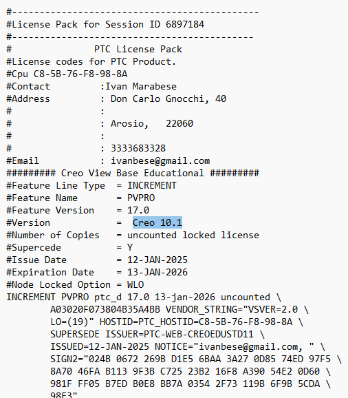

I got a student license dated May 2024 for Creo 9.1 which is shown as valid when installing version 11 but when starting the program got error -21: do I can renew he license or I have to retrieve the older version? (just to avoid mess with uninstalling the newest and installing the older). Thanks

Thank you Martin, but following the attached procedure a license for 10.1 is generated and still doesn't work with Creo 11
any further suggestion to solve?

the picture shows Creo View 10.1 license. I do not know why license file does not contain Creo View 11.0 license.

Indeed the license is for Creo looks like a Creo 10 license and it is not working for Creo 11. If you wish to use Creo 11, please use the guider provided to license Creo 11:
https://apps.ptc.com/schools/references/install_creo11_unistudent_standard.pdf
https://apps.ptc.com/schools/references/install_creo11_schools_standard.pdf
