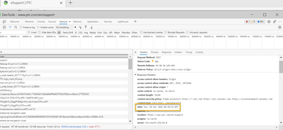

Hi everyone,
Thanks for keeping us updated on browsers affected etc.
A quick progress update from our side: We've found an incorrect header date being sent by one of our web server nodes. As the date is in the future (03-April-2022) and past the expiry date of the cookies used for log-in, the authentication is failing:
We're working to identify where this date (which remains static) is coming from, as the server's own date / time is correct.

Hello all,
(Hopefully) a last update from me on this thread to let you know the issue is now resolved. The underlying cause was a time sync issue between our servers and Microsoft time servers which our infrastructure team will investigate further.
A server reboot allowed all of the services to reset and pickup the correct time again, meaning the login cookies will no longer be seen as expired on issue.
