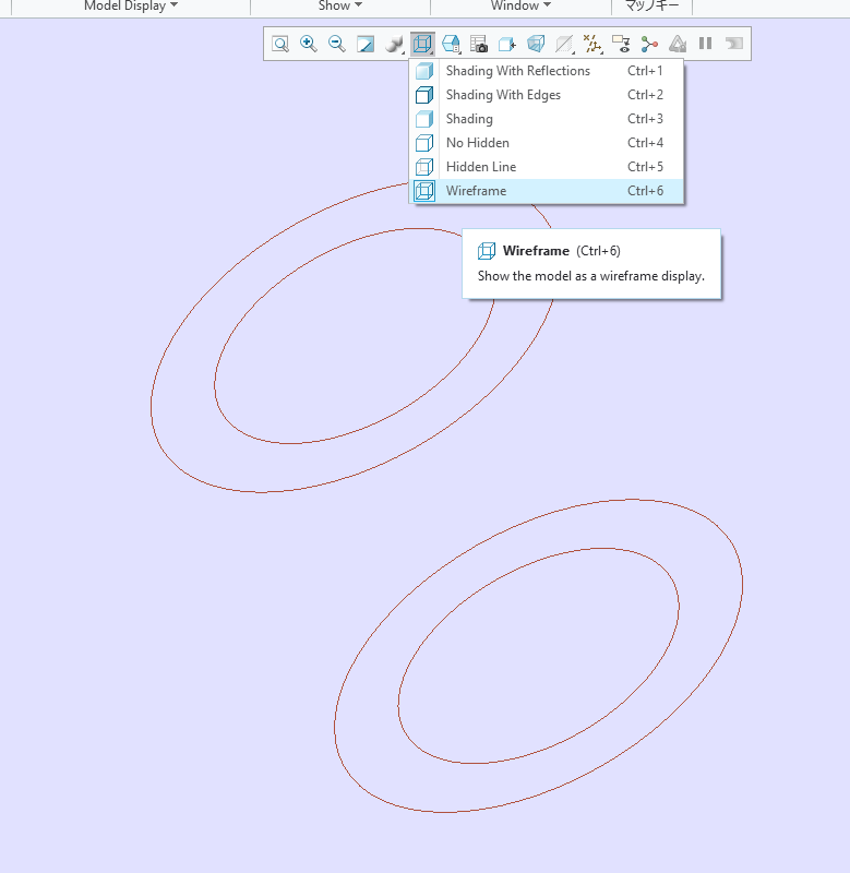

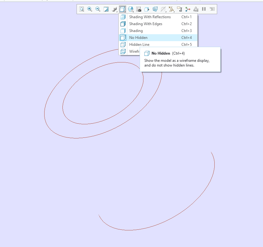

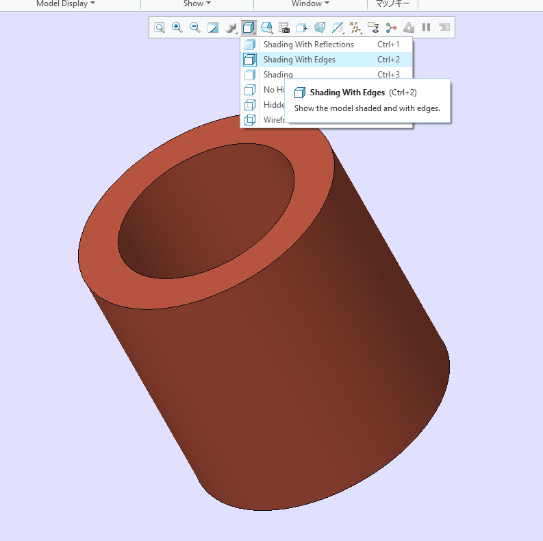

Here is a hollow cylinder I modeled and here is how it is displayed in various display states.

tbraxton
22-Sapphire I
(To:pausob)
The default value for that option is yes so someone would have to override that to cause this problem.
 @GG_10900066  launch Creo without any environment customizations and then observe what happens with display.
