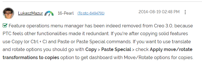

@MN_10261068 wrote:
I am using Creo Parametric Release 8.0 and Datecode8.0.6.0
I would like to know is in Creo 8 available a function: "Feature Operation" in the "Model" tab? This function was available in Creo 2, but I cannot find it in Creo 8 interface.
https://community.ptc.com/t5/3D-Part-Assembly-Design/Feature-Operations/td-p/20241 discussion contains following reply:
