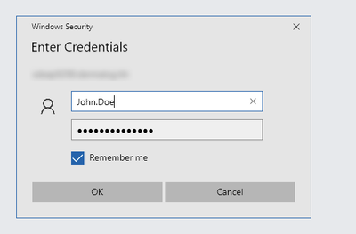

Hi there,
one of my colleagues has an issue with his windchill login in Creo Parametric 8.0.6.0.
He has to type in his credentials every time Creo starts. The "remember my password" checkbox seams to be ignored.
I found this case https://www.ptc.com/en/support/article/CS257316 , but it was not helpful.
Where does chromium store its passwords (maybe that file is corrupted / broken)?
Or any other clues?
Any help would be appreciated.

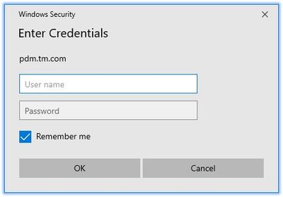

Mat
(To:TomU)
Thanks Tom,
I can confirm, that Creo 8.0.6.0 has the newer credential manager:
And when my colleague and I updated Creo, we had to type in our credentials again. No problem there.
But his installation refuses to remember his credentials.
He has to type in his username and password every time he starts Creo.

Odd, we're all running 8.0.6.0 here and not having any issues with it remembering the passwords.  Maybe try creating a new cache or at least deleting the embedded browser cache.  See https://www.ptc.com/en/support/article/cs368331

Is the password being stored by Windchill/Creo or by Windows? Maybe the user selected Never when Windows asked to remember the password.

Mat
(To:Mat)
deleting the cache and a (maybe corrupt) credential entry solved the problem.
Thanks all for Your help
