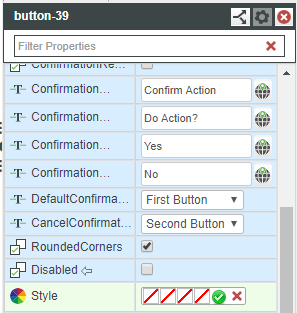

Which part is not clear?
1. Overlap the Button widget with the ValueDisplay widget, put it in top-right corner.
2. Change the Button Style with a X image  (I don't have that at hand, use another one)
3. Figure out the "Close/ delete image" logic in a service and trigger it by this Button.  (Don't know how you want to delete image in ValueDisplay, so you need to do the customization yourself)
