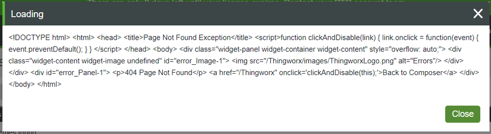

@zyuan1  I tried to search in style theme(BETA) but i did not find any theme. Have attached image for same.
Also i did try y directly searching for base theme file but i am getting popup window with error "Page BaseThemeError.PNGCapture.PNGnot found exception"(attached image).
It's a default entity, you should check the box first

@zyuan1  I got same error after opening the base theme "Page not found exception"
