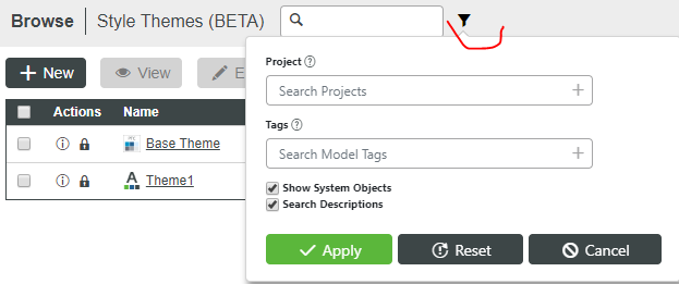

I can not see widgets in Design tab while creating mashup. Getting below error. Please see the below images.Capture1.PNGCapture.PNG

@manglapr   If your TWX 8.4.2 server is installed by using Navigate 1.9 installer, then it's a proved bug that the Base Style Theme can't be found due to web.xml setting problem, and will cause this scenario (Design mode in mashup blank).  But you mentioned you're using Navigate 1.8, that's strange.

Check if you can open the Base Theme (hidden in System Objects) in Style Theme (Beta) in the composer, if you can , then it's not the problem I mentioned, if you can't, I can send you the modified version.

@zyuan1  I tried to search in style theme(BETA) but i did not find any theme. Have attached image for same.
Also i did try y directly searching for base theme file but i am getting popup window with error "Page BaseThemeError.PNGCapture.PNGnot found exception"(attached image).
It's a default entity, you should check the box first

@zyuan1  I got same error after opening the base theme "Page not found exception"
You can compare with what you have now and check for the edits.
