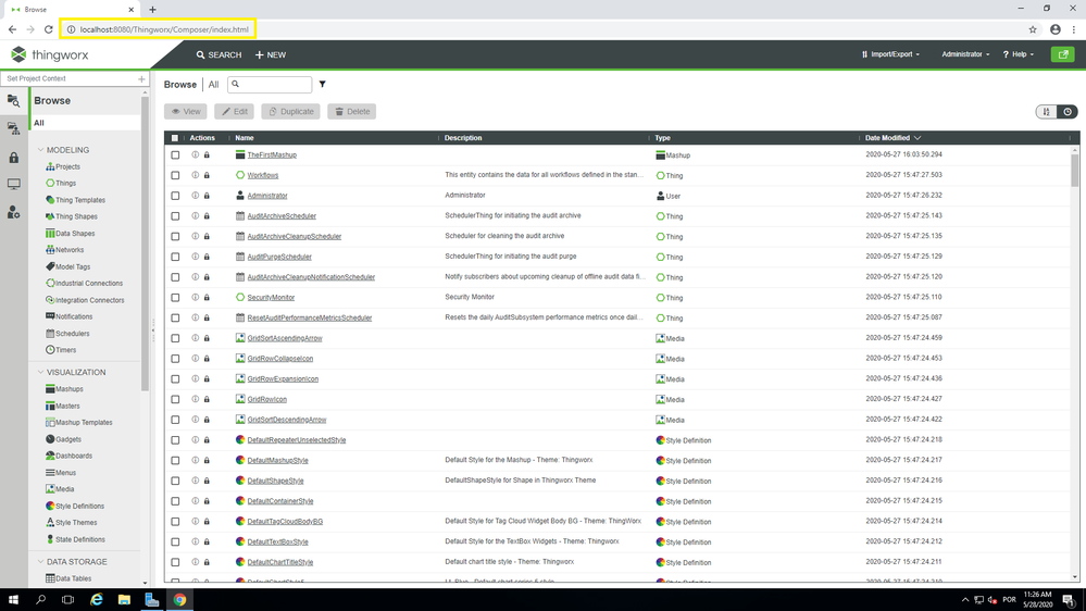

Another information:
I am able to navigate to Thingworx in my virtual machina (AZURE). Image bellow:
Since you are able to access ThingWorx from localhost there is no issue with your tomcat or ThingWorx. You may have to open port 8080 in the Firewall settings of your VM.
