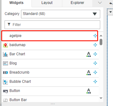

Is this a plugin bug?
I've removed the plugin extension, why does the plugin still exist?企业微信截图_17084829778174.png
and if that does not help maybe the issue is just with browser cache. try if it still appears in a private tab.
also check in installed extensions that it actually was deleted as you expect.

The version is 9.2.3,Please help me

Hi @Snoopy_hu
Have you tried restarting your instance ?

I reopened thingworx and it's still there.

Hi @Snoopy_hu
Please restart your Thingworx Instance (including DB) and try it
Yeah, you're right. Thanks!
Yes clearing the browser cache did the trick!
