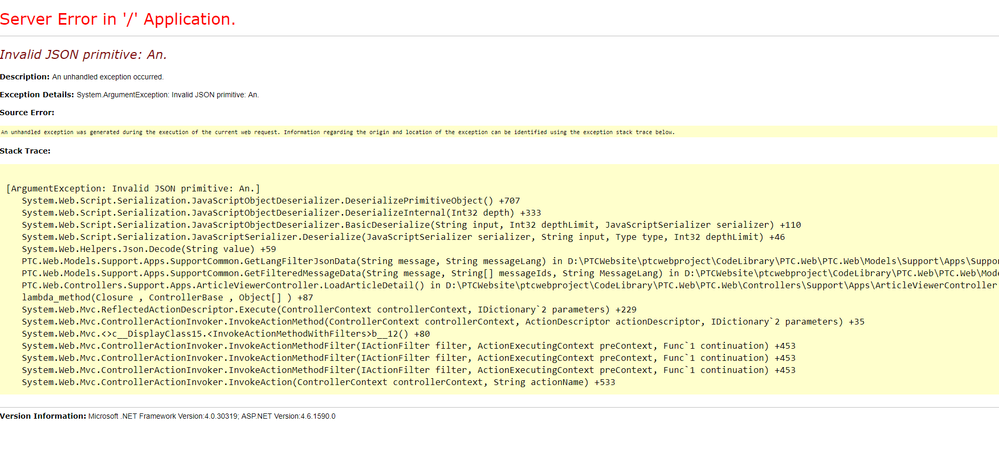

Hi Christophe,
thank you for your fast reply. Seems there is something wrong with my machine then, your link appears like this for me:
I never saw anything similar and i didnt find any proper solutions in the internet. Could you either Copy Paste the important instructions from your link or tell me how to get this link to work for me please?
