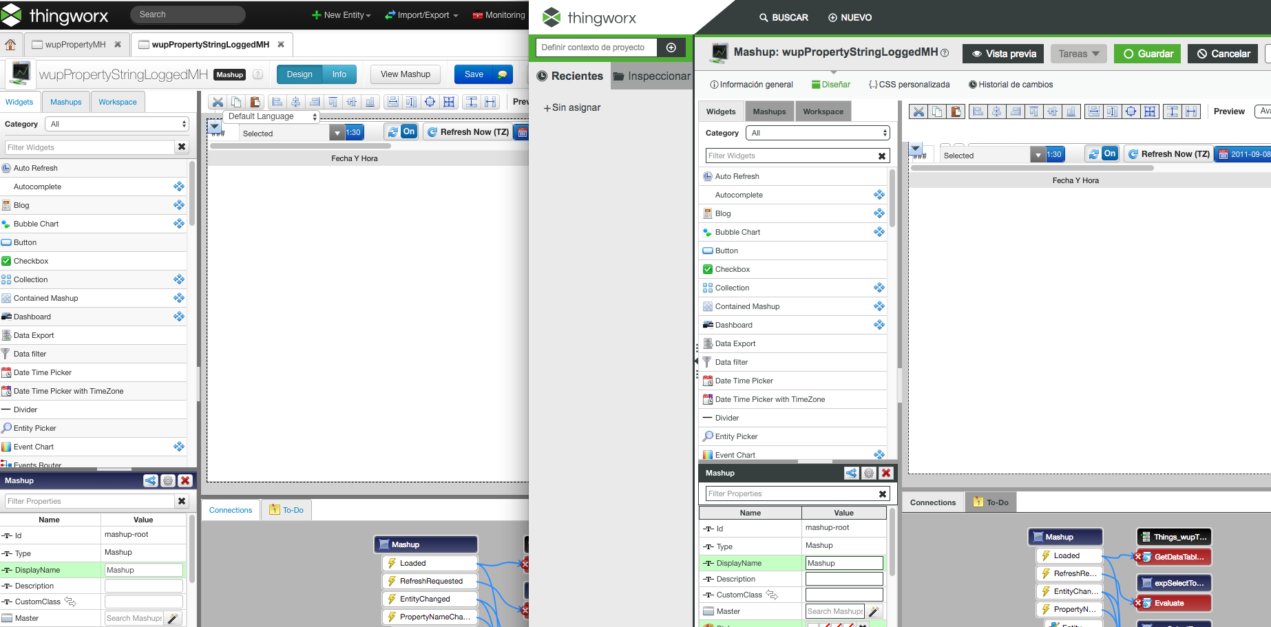

tk512
(To:CarlesColl)
@CarlesColl When you say the old Composer, what is meant by that? I am using the standard Composer found in ThingWorx 8.2.2
On the left the old composer on the right the new one:
tk512
(To:CarlesColl)
Thanks. I think the difference is minimal - just a skin basically. I can confirm that we are using the old Composer though, so it's good to know that at least we are testing the same you are using.
