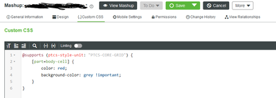

For me this seems to work:
@supports (ptcs-style-unit: "PTCS-CORE-GRID") {
[part=body-cell] {
color: red;
background-color: grey !important;

I add this css to the mashup CSS
You have to put Linting off tho.

Yeah, I turned off Linting but still its not rendering css changes in runtime. Is it due to Thingworx version? I am on 9.3.2.
Attached mashup for reference.

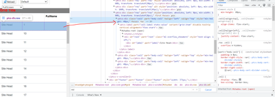

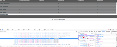

Strange!
Applying same css directly in inspection window(F12) works but not working when applied in Mashup CSS editor.
[part=body-cell] {
justify-self: center;

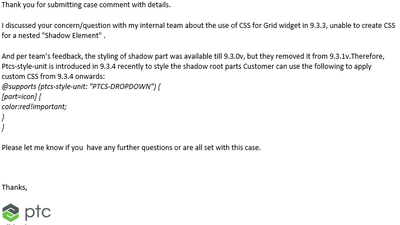

I made a support ticket on this a few moths ago.
This was the reply:

you want to this:
.widget-ptcsgrid::part(body)::part(row)::part(body-cell) {
color: red;
but this is not allowed in css.
so there is no way to access it at you version of thingworx.
so if it is essential to make this work you have to downgrade or upgrade.
