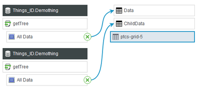

If i remember correctly, you have to provide the column names for parentId maybe also HasChildrenFieldName.
ChildData can be the same infotable as Data.
