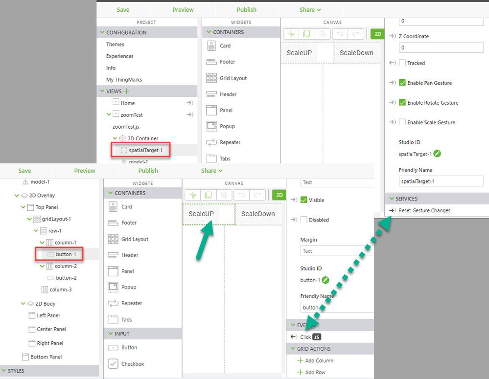

May binding the click event to reset of the spatial target would help?
 CheerEO
Marco
(Presales) Senior Technical Consultant @ INNEO Solutions GmbH (Germany)

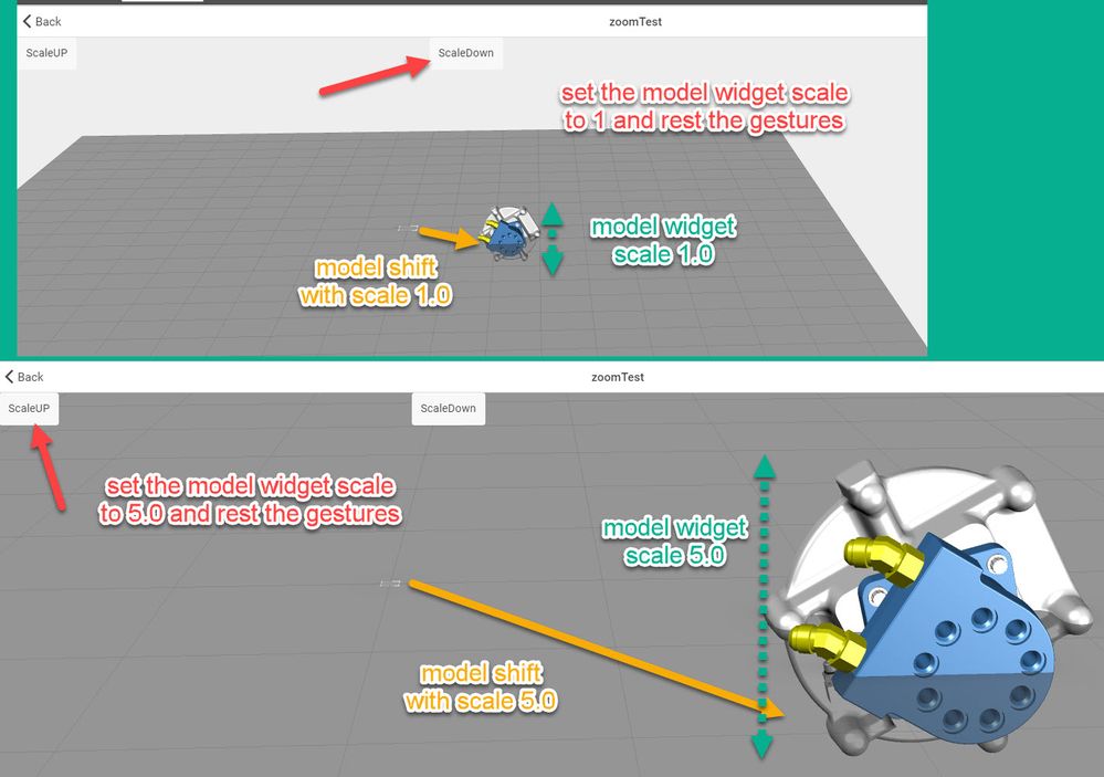

Yes, this is possible, we can bind e.g. the button click event to the spatial Target reset service
but this will reset only the changes which are done using gestures - OK in this case it will work.
But when the shift already exist in the model in this case we cannot reset the shift and when we will scale the model the it will scale also the shift. (picture below)
What we can for each specific model calculate a x,y,z movement which could be aplied to the model to move it back  - so that when scaling the model with specific factor it will scale up but will not move
