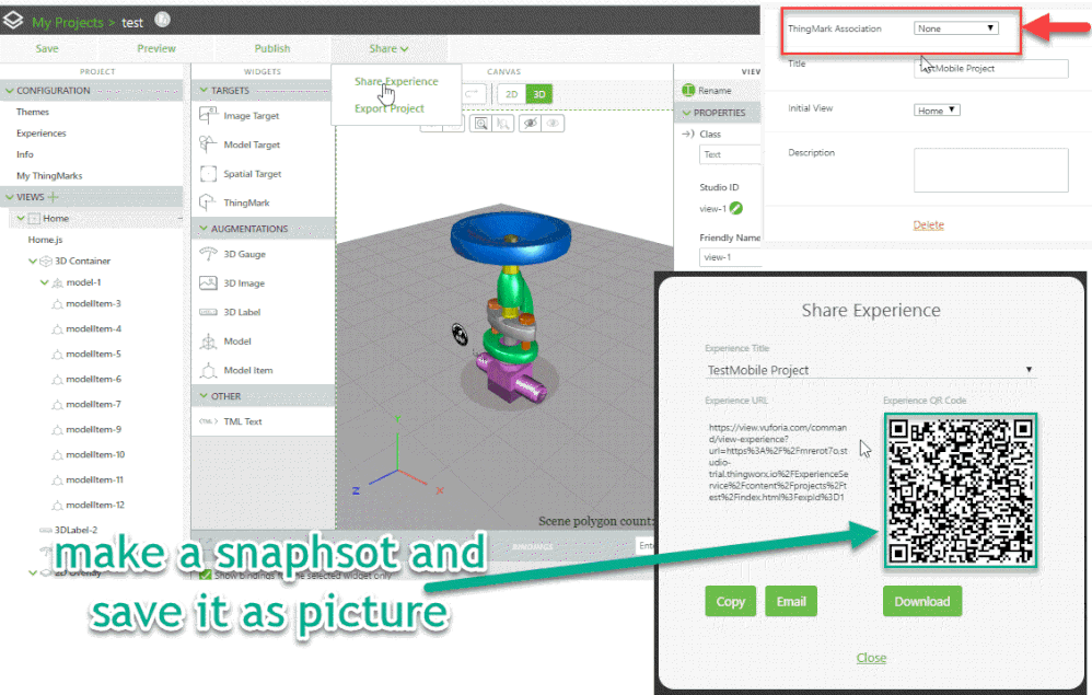

Hi @ppandarkar-2 ,
it is very simple.
If you have an project which was published you can share it.  Example>:
So you can make a picture of this QR code and you can scan it later when you want read the proejct in Vuforia View. So on this way you can achieve to retrieve the correct project.

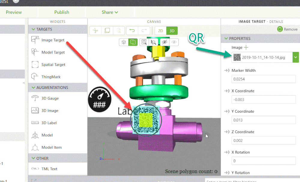

Now you need to get the correct postion of the project . You can achieve this by using he same picutre (of the shared project QR code) in a image target:
I hope this will make it clear, if not , then , please , let me know!

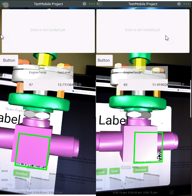

...but I am not convince that the the statement is  true  that the QR code does not work as Image Target. I tested it and it was working fine on android. Yes the QR code as picture has no so much contrast and  may be will lead to difuctulties for the setting of the significant picture points for picture detection...  but on my  current test  it was working  so far and it did  not make an difference if I used another picture with more contrast:
This above is an example for calling a project with QR  as image target on Samsung Galaxy S9+
