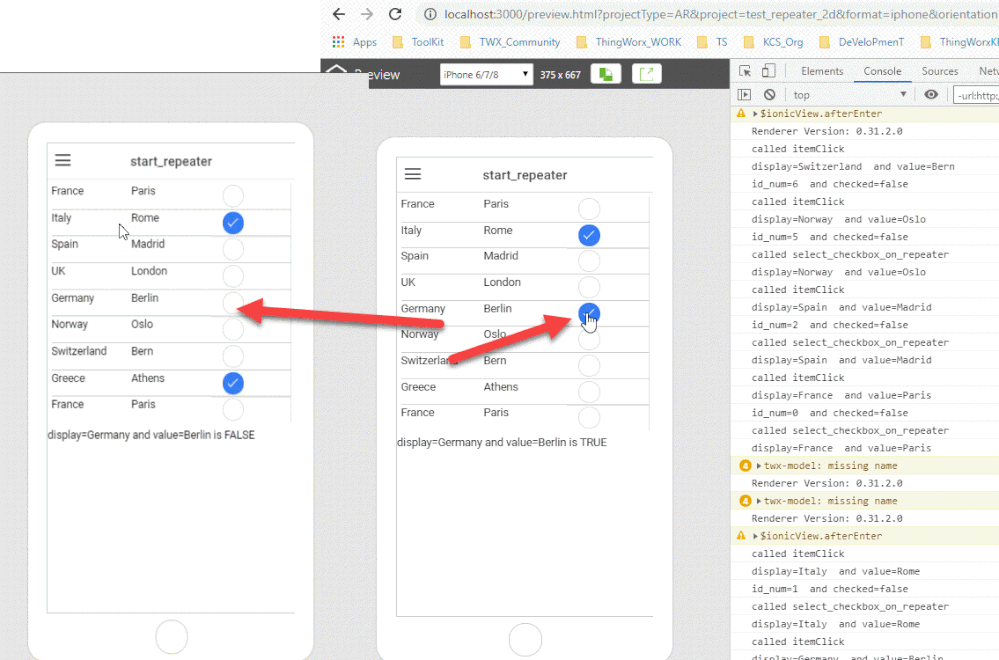

And in Vuforia Studio some code like this to handle the selection:
$scope.value="";
$scope.display="";
$scope.itemClick= function(){ // repeater click event
console.log("called itemClick");
  try{
  let data =$scope.app.mdl['TestService'].svc['returnJsonValue'].data;
  let value   = data.current['value']
  let display = data.current['display']
  let id_num=    data.current['id_num']
  let checked=    data.current['checked']
  $scope.id_num=id_num;
  $scope.checked=checked;
  $scope.value=value
  $scope.display=display
  var str1 =  "display="+display +"  and value="+value
  console.log(str1)
  var str2 ="id_num="+id_num +"  and checked="+checked;
  console.log(str2)
  $scope.setWidgetProp('label-3', 'text', str1+" "+str2);
  $scope.$applyAsync();
  } catch (e) {console.log("display="+$scope.display +"  and value="+$scope.value)
               console.log("id_num="+$scope.id_num +"  and checked="+$scope.checked)
               $scope.setWidgetProp('label-3', 'text',"display="+$scope.display +"  and value="+$scope.value);
           //clicked second time the selected repeater row
$scope.select_checkbox_on_repeater= function(){ //repeater checkbox select event
console.log("called select_checkbox_on_repeater");
$scope.setWidgetProp('label-3', 'text',"display="+$scope.display +"  and value="+$scope.value + " is TRUE");
$scope.deselect_checkbox_on_repeater= function(){ //repeater checkbox deselect event
console.log("called deselect_checkbox_on_repeater");
$scope.setWidgetProp('label-3', 'text',"display="+$scope.display +"  and value="+$scope.value+ " is FALSE");
