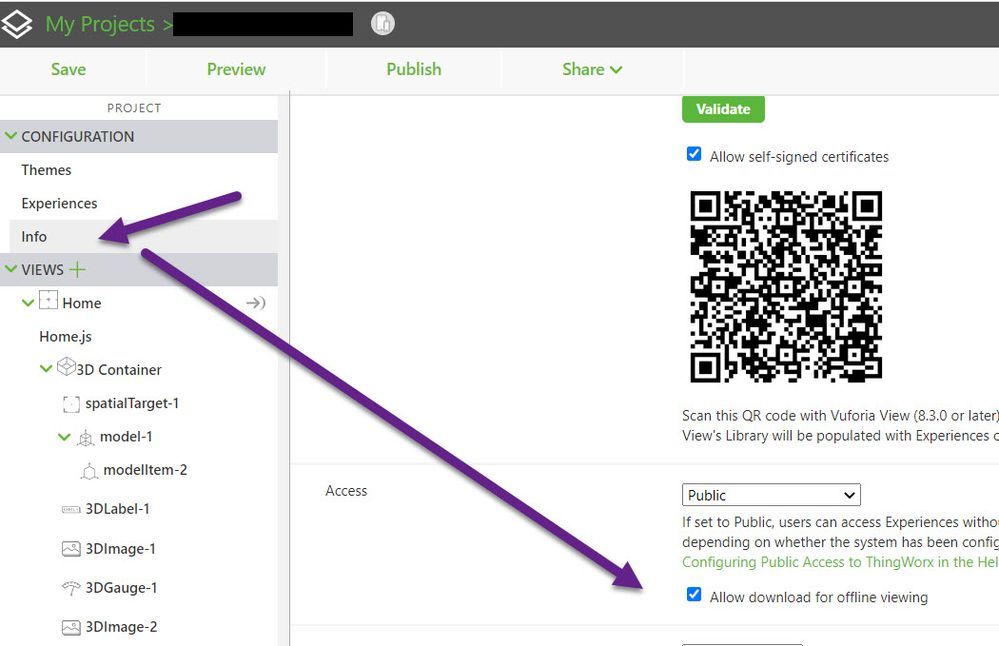

Is it possible to save a Vuforia Studio A/R experience to a device without using Experience Server?
JG_9770075
Is there any way to copy a Vuforia Studio A/R experience to local storage on a HoloLens/MagicLeap device and run it without ever connecting to an Experience Server?
3 REPLIES 3
Hi @JG_9770075 ,
the Vuforia Studio experience Project (for Eyewear device) should be marked as "Allow download for offline viewing" and published on the Experience Service
Then you can scan the Studio Project via Thingmark, QR  code or deep link (  provided by Tab Share>Share Experience)
According to http://support.ptc.com/help/vuforia/studio/en/#page/Studio_Help_Center%2FEyewearViewAndHololens.html
You can use then the HoloLens voice command “Hey View, download experience.”   ->Downloads the experience ( what you currently scanned to the device for offline viewing.
Also see related post
Thanks, but just want to confirm: you still need the experience server to do the initial download. There's no way to put the experience on the HoloLens without the experience server, correct?
So far I know the current functionality , yes, ->to put the experience as offline to the device you need to scan it from experience Service and downloads then in View . I do not know another mechanism to copy the project directly to the device  and it is currently not supported
