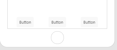

Hi Everyone,
I just created a new empty 2d View in Vuforia Studio.
I added a footer with a grid layout inside but the grid layout does not cover the full width. (see Screenshot)
Now I would like the footer to stretch full width with a 3 Column Layout with elements on the left, right and center of screen.
How can I achieve this?

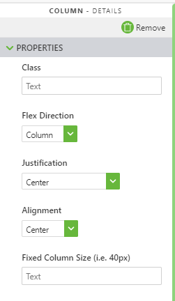

The grid actually does cover the whole width, it just looks a little wonky in the canvas. If you preview or publish and view on a device, you should see that the items are displayed correctly. I created 3 columns with a button in each and set each columns justification & alignment to 'center'.  I confirmed that it displays correctly on an iPhone and iPad.
You can also manually define your column width within the column properties.

Hi tmccombie,
Thank you for the quick response!
You are right it only looks strange in the canvas.
When I start the Preview everything works like expected.
