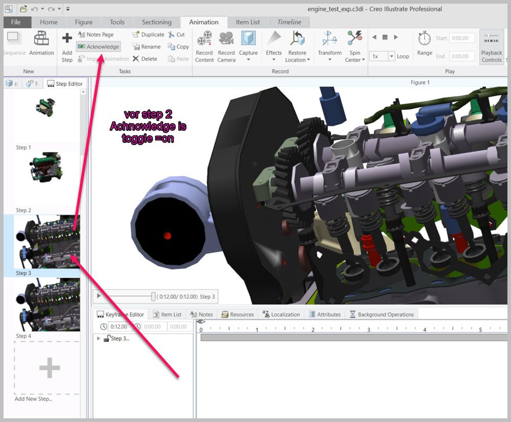

So far I know there is an event what we can use
The following steps
1.) in Creo Illustrate define for a step
then when we publish to pvz and play in Creo View the sequence we can see the Acknowledgement:
2.) ON the HoloLense then we could use the Model Event "Acknowledge Requested"
Where we can use some code like this :

When we are calling "playAll" service here via double tap then it will stop the sequence after the acknowledge event and we need again the call playAll to continue the sequence until the end of the sequence  or until next acknowledgement occurs.  I did not test it further but may be we can implement more  complex logic to continue or to play the current step event  again . In this case we need also to evaluate the arguments of the "stepstarted" and "stepcompleted" events
