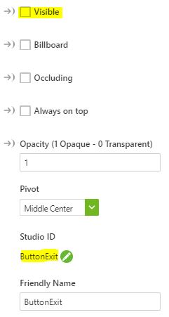

  $scope.view.wdg['Button2']['visible']= visibilityswitch;
//This line makes Button2 visible when first run.
//Make sure, that Button2 (your 3D Image) is not checked at “Visible”.
//Also make sure, that your 3D Images have the right name under Studio ID, in this case “Button1” and “Button2”.
