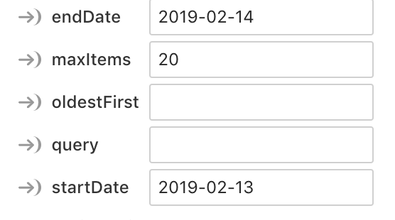

I played around with the Parameters which looked like this:

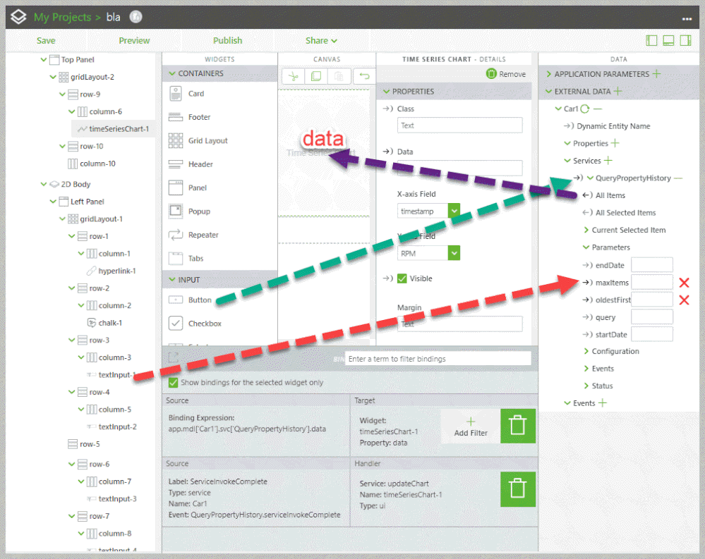

so far I understand your problem you want to call the QueryPropertyHistory  service with parameters so to select a specific data  inside some parameter range.
If  it is not caused on some restiction on your trial instance- so passing the parameters to the service - this should work fine.
So  you have to :
1.) bind the all data of the QueryPropertyHistory service to the data of the  Time Series Chart widget
2.) second point is to call the service / for example by clicking of a button , where you will pass also the parameters (for example via binding of Text Input values directly to the service parameters) . I tested only  using  one parameter/severice argument -  "maxItems" to reduce the resulst set  - to be sure that there is no some mistake by the passed parmeter values /some values which will not find data
3.) Bind ServiceInvoceComplete Event of the QueryPropertyHistory service to the update Chart service of the  time Series Chart widget

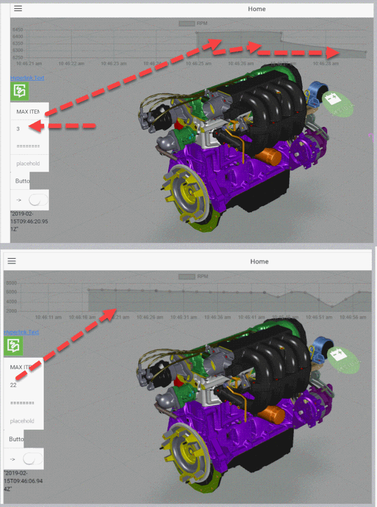

So this will have the effect that when you change the parameter  maxItems  e.g  via Text Input Widget and then call teh service QueryPropertyHistory  - in this case the Time Series Chart widget will display only number of data points  which is specified by the value of the "maxItems" parameter
Here some picture to my previous replay , so hope it make it more clear
1.) in the design mode
And then the display when testing it in preview mode:
