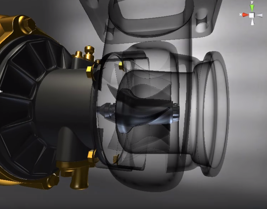

How do I get the details like this? https://www.youtube.com/watch?v=0UJt9mYSSis
Especially the surfaces inside the structure.

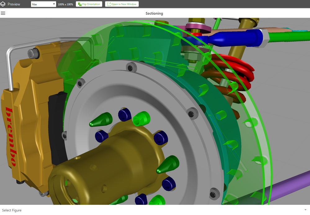

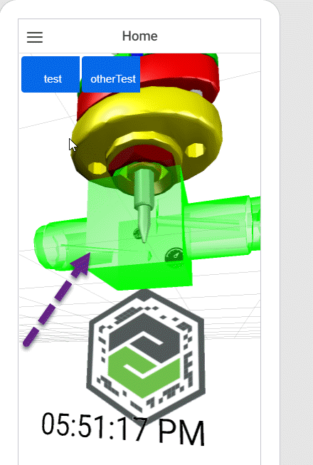

Mar 28, 2019 4:52 PM UTC
OK this info is here only as summary for people who are looking for the solution of this topic
To generate x-ray like in unity the following steps:

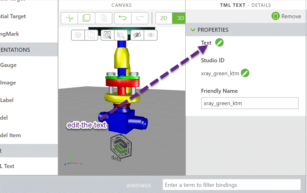

Create a TML Text  widget:
Edit the Text property and add the following  code:
