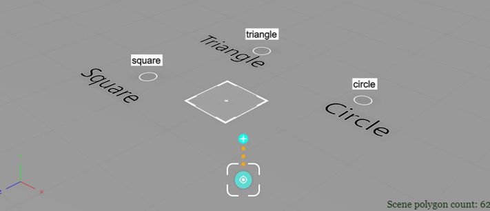

Testing on an iPhone 11 Pro and finding the ribbon dots a bit small. The waypoint location is marked by a white, unfilled circle that does not really stand out; it would be nice if the ribbon's destination was more obvious. I tried changing the .svg of the the circle to orange with a wider stroke, but the program seems to overwrite the file every time I replace it.
AmberWright
(To:FionaC)
Hi FionaC,
Thank you for your feedback! Would you be willing to send us a screenshot of what you are seeing? It would be helpful to understand the type of environment you are trying to use the Wayfinder in so we can understand the different types of situations our users are experiencing.

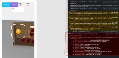

Anyway, I've noticed that the departed event happens only when reaching the last point, see the picture.
I also played with the next/prev buttons and only when arriving and leaving to the last POI it fires the departed event.

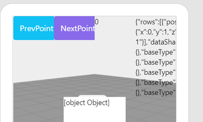

Hi @RolandRaytchev , I've started implementing your solution into a project but it looks like it's not working anymore.
Basically it's not showing the values on the labels. Did anything change behind the scenes with the official release of the widget?
I'd like to jump to a specific waypoint by pressing a toggle. But again, the main fact is that also your solution now gives back errors
See below, lables have not been updated, nor the value label and errors in the debug.

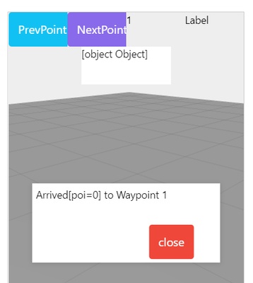

Now I've edited the JS replacing the properties with the new names.
What happens then:
Using the popup from JS showing, respectively, 'selectedWaypointIndex' and 'selectedWaypointData' works as expected.
If you look above, the text area shows [object object] and the second label has been disabled.
The bindings are:
- 'selectedWaypointData' -> text-area 'text'
- none to the 2nd label
If I bind the 'selectedWaypointData' to the label I'll get this
How can I then get the waypoint "name" in a label without scripting it in JS?
I apologize in advance if I missed something obvious out. I tried several times before posting 😅
