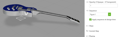

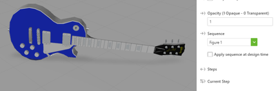

Thanks, Tara. Can you give a little more information about this item:
It's not clear to me what that means, or when I would want to use it (or not). Thanks.
--Clay
Hi Clay,
This feature allows you to view your model during design as it will show in the experience based on the sequence selected. It is a check box found under the sequence selector for the model.
model loaded into Studio
sequence applied at design time
Hope this helps!
It does, thanks!

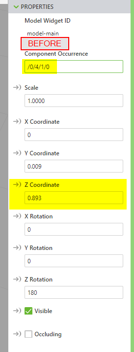

@tmccombie So i thought one of the uses for the "Apply sequence at design time" would be to allow easy picking of model items. As in you can set your model to an exploded state, apply it in design and then create all your modelItems and switch back to the default state.
It seems that when you create the modelItems in this applied state they take their position from where they are in 3D at creation time. Which means you can never go back to that unexploded state. It also really messes up any sequences you have as the items will be in this wrong position until they first time they are moved in the sequence and then will jump to their correct initial position and move as defined in the sequence.
The take away here is: Do not create model items in an applied sequence state!
If anyone knows a way to reset like 100 model items positions please let me know. 😞
Perfect timing on this release, i was minutes away from redoing hours worth of work.

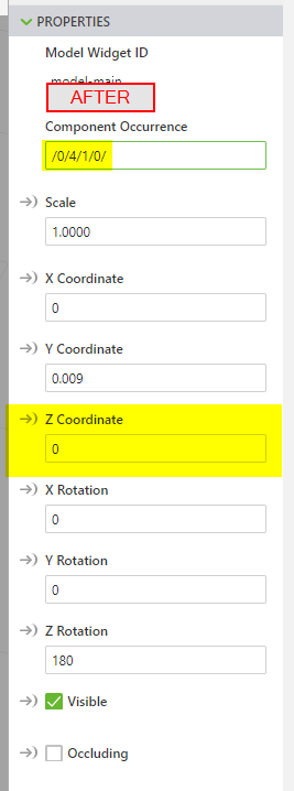

8.3.4 provides a fix for the mode item problem I was having. Prior to 8.3.3 you could get a modelitem to "refresh" it's coordinates, as in set them back to what they are in the assembly by typing a "/" after the occurrence ID. This was not working in 8.3.3. but it is now working again in 8.3.4.
Here is the procedure. Simply select your modelItem and add a slash "/" at the end of the occurrence ID. As soon as you type this you should see the coordinates update. You can then delete the slash and the coordinates will remain. I'm not sure what will happen if you leave the slash on the end.
Before anyone mentions that I could have just typed in 0 for "z", this was a bad example. Most of my items have non-zero values for the correct coordinates.
As best i can tell there is now a checkbox under "Sequence" for Model widget items that says "Apply sequence at design time" If you check this the component visibility defined in the sequence is applied in the design 3D view, but not any animation steps in the sequence.
All my sequences start with the parts in the same position so i'm not sure if you had Step 0 defined with parts in a different position maybe the parts in design would go to that location when you picked that sequence?
Thanks. I had found the control in the Studio UI, but wasn't sure what the effect was. I think I get it now.
