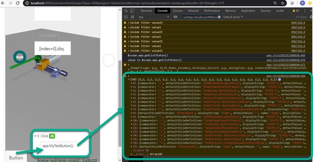

$scope.app.MyTestButton= function() {
console.log( "$scope.app.getListStates()" )
console.warn( $scope.app.getListStates())
This is similar to the filter definition mentioned above. Here the function will write the stateNames of TestState1-100 to the javascript list myList. You can change this code to add all required filed  of the stated definition to your list.
Example when I tested it :
March 4, 2020
I found there a mistake in the last displayed pictures.
The printings to the debugging console of the last picture is the first print of the test button function which is not so relevant- it contains all states Definitions. The more important print the state definition State1-100 is the same as shown in the picture above
