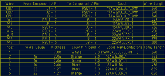

In our drawings we use BOM tables as shown below (one example table)...
After routing your wires and cables you should have one or more cable parts. Usually we create a drawing for each cable part. For the BOM table we set the "Repeat Region -> Model/Rep" to be the cable part (e.g. mycable.prt). Then the table may look like this... Most parameters come from the schematic except the lenght.
The report parameters for each item above (as shown in properties dialog for each region)
Harness Connection Table Items
Wire           - &harn.run.name
From Component - &harn.run.cond.from.conn.name
Pin            - &harn.run.cond.from.pin.name
To Component   - &harn.run.cond.to.conn.name
Pin            - &harn.run.cond.to.pin.name
Spool          - &harn.run.spool.name
Wire Length    - &harn.run.len[.0]
Index          - &rpt.index
Wire Gauge     - &harn.spool.WIRE_GAUGE
Thickness      - &harn.spool.THICKNESS[.2]
Color          - &harn.spool.COLOR
Min bed R      - &harn.spool.MIN_BEND_RADIUS[.1]
Spool Name     - &harn.spool.name
Conductors     - &harn.spool.NUM_CONDUCTORS
Total Length   - &harn.spool.len[.0]

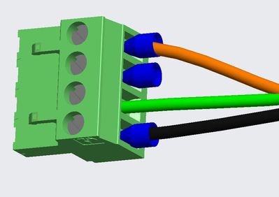

Hi Eric,
We don't use cavity plugs so I can't help there.
I would probably make an assembly of the connector and the plugs... Similar to when we sometimes use ferrules in our connectors...
(The demo contains wiring error. The green wire should go to the ferrule). For this connector I can create a bom where I could filter out the connector parts.
You might be able to use the connector terminators also for this purpose... but they only exist if you route something into the connector.

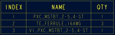

Our connector library (schematic) always contains the appropriate crimp contacts (terminators) for that connector. For example if we route 4 wires to 6 position SPOX connector then our terminator table looks as shown here. Although only the "Terminator Name" comes from the schematic. Then we separately load "0870-1039.trm" -file to creo to get the Manufacturer, etc info. I haven't yet figured out how I could get all the terminator info passed to creo in the schematic .xml file... or do we always need a separate terminator table.
Br,
Lars
Hi Lars,
That last table that you posted with the QTY of the terminators is exactly what I need. How were you able to call that information within the table? We don't actually currently have CAD for the terminators. I was hoping that I could include the information in the BOM tables using purely the XML file. However, I cannot figure out out to call it.
