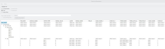

I don't use the terminator tables but I did test the tables in the past. I don't know whether you can modify any other parameter than the TERM_NAME with the terminator tables. As an example I did flat_test.asm
When I view the Cabling Parameters for the 4-pin vh-connector J4
Table shows the terminator "SVH-41T-P1_1" for both CBL2 and CBL3 (this is read from the Schematic xml).
Open terminator table "test_table.ttb". The terminator table looks like on image below.
The I press "Execute". I did create a TEST_TERM_1.trm file to test if Creo would automatically load the matching .trm file when changing the terminator...
After executing the terminator table I checked the Cabling Parameters again for J4
Table shows terminator TEST_TERM_1 for the 24AWG wires (CBL2) and
TEST_ANOTHER_2 for the 22AWG wires (CBL3).
So all terminators were automatically changed. But then I still need to load the *.trm files manually for these new terminators if I want to get the DESCRIPTION, MANUFACTURER, etc parameters (Creo did not perform any autoload for the .trm files).
I believe I could get all information from the Schematic XML if I use the parameters
asm.mbr.connprm.pin.term.name (this already exists)
asm.mbr.connprm.pin.term.<User Defined>
Where I could add the all kind of user defined parameters for the terminators... But then it again seems that the xml should contain a lot of extra pin-parameters just for the terminators...
If I have time in the future I will test these options. Now I still load the .trm files manually...
