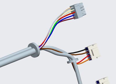

I would probably make an assembly of the connector and the plugs... Similar to when we sometimes use ferrules in our connectors...
(The demo contains wiring error. The green wire should go to the ferrule). For this connector I can create a bom where I could filter out the connector parts.
You might be able to use the connector terminators also for this purpose... but they only exist if you route something into the connector.
Our connector library (schematic) always contains the appropriate crimp contacts (terminators) for that connector. For example if we route 4 wires to 6 position SPOX connector then our terminator table looks as shown here. Although only the "Terminator Name" comes from the schematic. Then we separately load "0870-1039.trm" -file to creo to get the Manufacturer, etc info. I haven't yet figured out how I could get all the terminator info passed to creo in the schematic .xml file... or do we always need a separate terminator table.

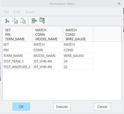

Hi Eric,
I don't use the terminator tables but I did test the tables in the past. I don't know whether you can modify any other parameter than the TERM_NAME with the terminator tables. As an example I did flat_test.asm
When I view the Cabling Parameters for the 4-pin vh-connector J4
Table shows the terminator "SVH-41T-P1_1" for both CBL2 and CBL3 (this is read from the Schematic xml).
Open terminator table "test_table.ttb". The terminator table looks like on image below.
The I press "Execute". I did create a TEST_TERM_1.trm file to test if Creo would automatically load the matching .trm file when changing the terminator...
After executing the terminator table I checked the Cabling Parameters again for J4
Table shows terminator TEST_TERM_1 for the 24AWG wires (CBL2) and
TEST_ANOTHER_2 for the 22AWG wires (CBL3).
So all terminators were automatically changed. But then I still need to load the *.trm files manually for these new terminators if I want to get the DESCRIPTION, MANUFACTURER, etc parameters (Creo did not perform any autoload for the .trm files).
I believe I could get all information from the Schematic XML if I use the parameters
asm.mbr.connprm.pin.term.name (this already exists)
asm.mbr.connprm.pin.term.<User Defined>
Where I could add the all kind of user defined parameters for the terminators... But then it again seems that the xml should contain a lot of extra pin-parameters just for the terminators...
If I have time in the future I will test these options. Now I still load the .trm files manually...
