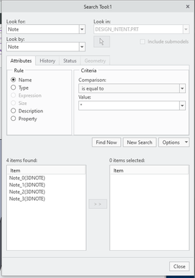

I was wondering is there a command in relations that can count how many notes exist in a part? also is there a command to see what the note id is without having to click on the note?
10 REPLIES 10
JB_87049
(To:KB_9100625)
To count the number of notes, you could do the following
  • press <ctrl><f>
  • select "look for : note" (see screenshot below)

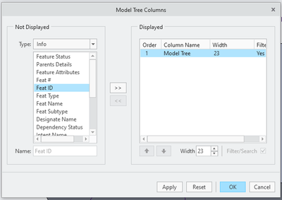

To see the id, you could add the id to a tree column

also i have noticed that the id on the model tree doesnt show the note ids

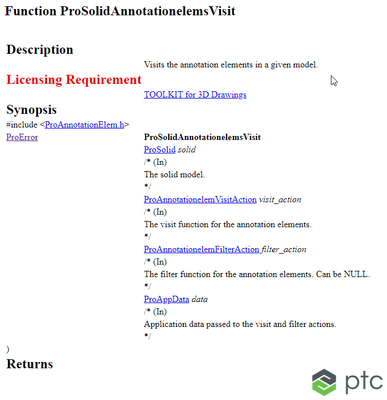

weblink is Creo's API in html language.
other offerings are dispensed in C, C++ and Java.
The Creo Toolkit function ProSolidAnnotationelemVisit is described as :
Visits the annotation elements in a given model.

The gist of an API is that you indeed need to create an application.
In the Creo world, it is called Toolkit and the offering varies according to the language you can code with. With this said the most spread, the most mature and powerful is Creo Toolkit (in C language).
