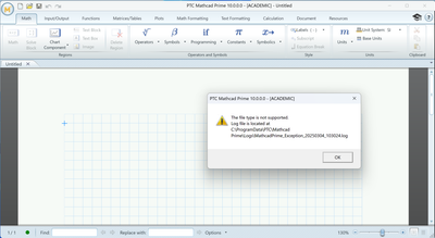

Hi i hope there is someone here who can help me.
I have the problem that I'm making an El authorization exam and suddenly I can't open my file, it just comes with this message the file type is not supported
a little info: I'm using Mathcad 10, the document was about 53 pages long, the document only contains simple calculations, text fields and images that are copied in so no extra ordinary programming.

Somehow your file got corrupted/truncated. According to people reporting here in the forum this happens quite often (too often IMHO), especially with longer files containing images or other regions (chart component, Excel component) which may take more time when saving the file.
Unfortunately PTC does not provide any means to repair such damaged files nor does Prime provide any means for automatic backup files to recover to. So you are on your own in making regular backups.

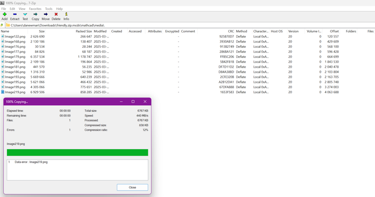

I tried opening the file (and renamed it to "friendly" just for good luck) with 7zip, and every image opens fine except this last one:
So... there's probably something wrong with how this was constructed.
Edit: As Werner implied above, there's fundamentally some missing files in the .xml bundle here that normally working worksheets have that Mathcad won't want to open without.
Yes, the last of the 12 files in the media directory is corrupted - possibly truncated. But given that its a 58 page document I assume that it contained more than just 12 images.

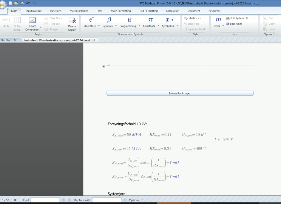

I came up with a version of the sheet which, when opened from within an already started Prime instance would show the beginning of the sheet for a moment but within a second or so closes and throws the error. Within this second the file can not be edited, scrolled or saved, so its of not much help seeing the first regions of that file
As can be seen its still a 58 page document, possibly missing quite a lot of regions (mainly images, I guess).
I think it would be necessary to locate and delete the regions in worksheet.xml which refer to missing images, but the log file is not of much help here.
