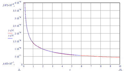

(To:PW_10297783)
You have to write y(x), not just y.
Furthermore I guess you will run into problems because the right hand term is not defined for the start value x=0 (division by zero).
I changed the start value to x=10^-10 and it works OK.
Here done in Mathcad 15 using "odesolve" with Adams/BDF chosen as algorithm.
I let x only run up to 1000 - you can see that y approaches zero continually.
For further questions please attach your worksheet, not just a picture. And in case you are using Prime also state which version.

The differential equation:
Has solution:
Now with:
we know c also.
So:
We can compare the numeric solution
with the exact solution:
The difference is:
