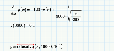

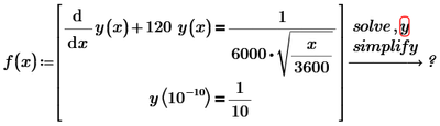

I am using Adams to solve the differential equations as below but failed, may anyone could suggest how to solve it or should I use another equation.The error can only disappear when x was deleted in the equation.
PW_10297783_1-1705961895174.png,x from 0 to 10000
Thanks in advance.

Your sheet is still missing - its not attached.
I see that you changed the initial value for x significantly now from 0 to 3600!
In Prime you would have to use the commands inside of a solve block!
The syntax for odesolve had changed, too, from legacy Mathcad to Prime (look it up in the help):
The attached file is in Format of Prime 6., so you should be able to open it with P7.

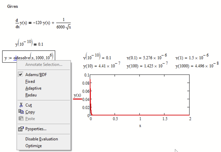

You have to write y(x), not just y.
Furthermore I guess you will run into problems because the right hand term is not defined for the start value x=0 (division by zero).
I changed the start value to x=10^-10 and it works OK.
Here done in Mathcad 15 using "odesolve" with Adams/BDF chosen as algorithm.
I let x only run up to 1000 - you can see that y approaches zero continually.
For further questions please attach your worksheet, not just a picture. And in case you are using Prime also state which version.

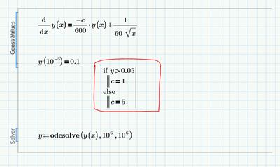

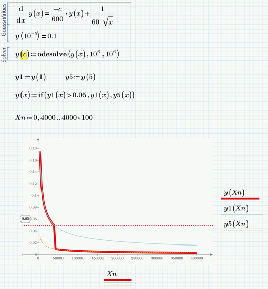

I come back to this topic further more,How could I make the If program fuction in this Odesolve modle please.I use Prime 9.0 now.
LucMeekes
(To:PW_10297783)
Not sure what you want. Note that in your solve block, y is a function: y(x), described by the ODE, and dependent on c. Now it appears that you want c (that y depends on) to change depending on the value of y....?
I see a chicken<>egg problem.
(To:PW_10297783)
I, too, see the chicken and egg problem mentioned by Luc 😉
I parametrized your solve block so you can create a solution for any given value of c.
Then I defined the two solution functions for c=1 and c=4 (y1 and y5).
Finally a function y was defined which equals y1 as long as its value is over 0.05 and then drops down to y5.
But I hardly can imagine that this is really what you are looking for ...
Prime 6 file attached
(To:Werner_E)
Here is a different approach with a similar result.
I used the if-function but of course you could as well use the program if-statement.
Still not sure if you are really looking for something like this.
This is exactly what I need,thank you both.

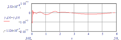

The differential equation:
Has solution:
Now with:
we know c also.
So:
We can compare the numeric solution
with the exact solution:
The difference is:

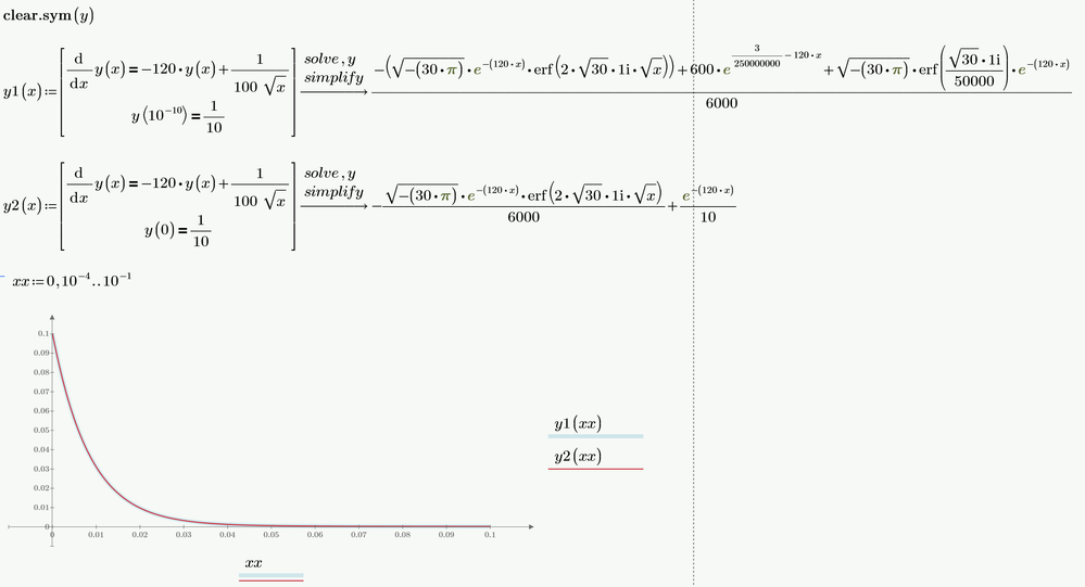

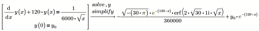

Forgot to mention that in case you are using a current version of Prime, the ODE can also be solved symbolically

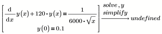

It also looks like we could add an initial condition
But the first attempt using a numeric value failed
Using 1/10 instead of 0.1 does the trick:
Using the prime symbol for the derivative you may even omit the function argument x, but I won't suggest doing so

You don't show the sheet and you don't say what the error message is you get, so we have to guess and either you forgot to clear y (at least for symbolical usage) before you solve symbolically (you can't solve for a variable or function which already is defined)
or its because you are still using Prime 7.  Version 9 is the first one with the ability to solve ODEs symbolically. That's the reason why I wrote  "Forgot to mention that in case you are using a current version of Prime, the ODE can also be solved symbolically".
For whatever its worth I nonetheless attach the P9 sheet with the symbolic solutions.
