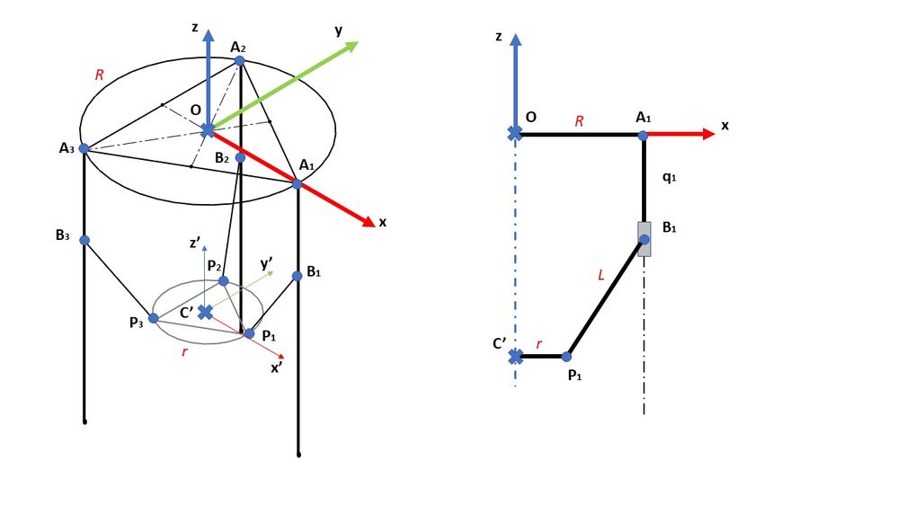

I write a new calculus sheet, with it, i want to calculate a kinematic for parallel glide structure(  is it a Clavel's Delta robot variation)
In my sheet, i don't understand why prime don't solve the last equation
see attached file
Anyone can help me ?

The reason is that OP.i is a matrix and so is the RHS of your equation!
If you clear OP.i (and L) for symbolic calcs, you get a symbolic result

I try to explain my problem, certainly i'm not clear, sorry for this.
I have a vector problem
 In this picture
I have 3 linear actuator :
  1. Axis A1 to B1
  2. Axis A2 to B2
  3. Axis A3 to B3
The Ai points are fixed ( i know each Ai) , the Bi point are moved. More presicely the Bi point moving is only on z axis (xy value for Bi point is know, and they are xy value from Ai)
The C point is the point of interest.
And is this point to move.
When i want to drive this robot, i give C coordinates (X,Y,Z) ( I make the inverse kinematic model)
And, C points coordinates values are know.
I know by building the L parameter , L is the standard vector ||BiPi||
And after that i calculate the kinematic close loop with vector, as in my sheet
Is that i want to use symbolic function in Prime
And finally , i want calcul the displacement parameter along each linear axis
This parameter is only  Bi coordinates along z axis.
And after i drive my motor with this parameter.
Sorry, i'm bad in mathcad use ...
I don't know how to do it, for realise your idea

Sorry, I don't know how to set up your kinematic problem.
I had not looked at the rest of your sheet, just at the last solve region to see why it didn't solve.
XDN
(To:Werner_E)
Do not be sorry,
I try to explain my kinematic problem for a global view
The kinematic, is not problem.
My problem is write equation in Prime with progam function using.
