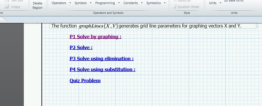

Can someone upload a worksheet sample on how to use Tags and internal Links

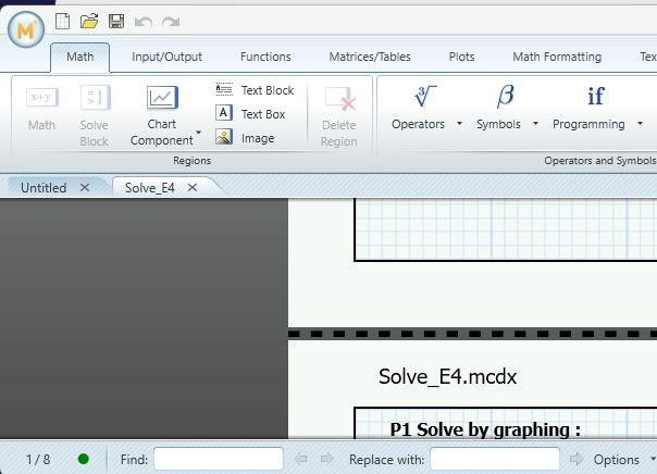

So is it really the intended normal behaviour that when you jump to a tagged region, that region ends up at the bottom of the screen and not at the top?  I  would consider this being quite strange and unintuitive (OK, having to use Ctrl-left click isn't intuitive either, I guess)!
Unlike in Microsoft Word and Excel etc the jumped to location does not have focus.  This means you jump to it at the bottom of the page but text or equation needs to then be selected.

The region not having the focus isn't that bad IMHO, but the worksheet should at least be scrolled so that the region is a the top and not at the bottom. This would make much more sense, the sheet of @rgunwaldsen  is a good example to show how bad the current behaviour is. Furthermore a simple left click or double click would be much preferable over the ctrl-click which is currently needed to trigger the jump.And of course a cursor change when you mouse-over a link so you clearly see thats it a link.

It is important.  Try this test in the provided file.  Give the focus to any point on the first page, say put the cursor to the left of graphLimits(X,Y).
This is not an uncommon start point at the top with focus at the top.
Now go [CTRL] and select "P1 Solving for graphing:" and you jump to the link putting it on the bottom of the page:
Now the next natural thing to do is hit the down arrow to see more of the page to see what "P1 Solve by graphing :" is about, but (and here's the rub) because the focus is back up the top Prime jumps back to the top to the first region below the focus.  This is less than optimum as we have just gone on a long round trip.
