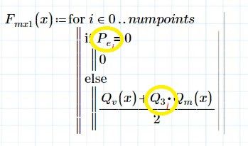

Hi ,
Please find attached mathcad 3.1 prime file
please solve the calculation for me and it will helpfull for my further calculation
Robert
LucMeekes
(To:ranto)
Need to index "Pe" and "Q3" by the index variable "i".
The program without a return value will only output the last thing it calculates.
Cheers
Terry
LucMeekes
(To:ranto)
Your error:
occurs because your x is an  array that contains a value of 0 in:
Hence your attempt to prevent the division by 0 in any of your forms of
Does not work.
