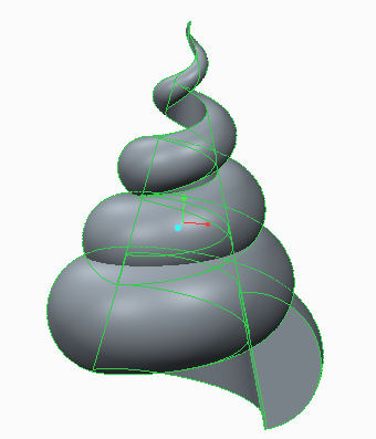

how about this one for a problem to solve.   I am trying to create a conch shell using the helical sweep tool, I can do it so far and then I hit a brick wall namely my mathematical ability, or should I say lack of mathematical ability.  The conch shell is creted in nature obeying rules that can best be described by the using Fibonacci principles.  That is the bit that beats me.  Using the Vary Section option I can create a pseudo conch shell. See below
What I would like to do is now vary the pitch so that it changes related to the fibonacci series.  Has anyone any clues to how I might do this.  The Hel;ical sweep has a variable pitch function in Creo Parametric by setting a series of points along the profile curve axis.  If I can set the points in the ratio of 1.618 , the golden section I think I can do it.  Am I on the right track?  I attach my Schools Edition file just in case anyone else would like to play.

    Interesting situation! Unfortunately I cannot read the student version to see what you have tried thus far. Can you explain a little more what you have done in the file attached? Are both the pitch and the section diameter affected by the same 1.618 ratio?
    JohnF1-VisitorAuthor
    November 30, 2011
    Hi Gregory
    The spiral was created using the Helical Sweep tool in Creo Parameteric with a constant pitch but using a surface cone to which the section was locked by a tangent using tehVary Section option in the Helcal Sweep tool.  As you can see from the image this creates what looks like a conch but because I cannot vary the pitch geometrically/parametrically it does not create a proper conch spiral or equiangle spiral. The pitch needs to change by 20% per revolution roughly however the math is somewhat complex.  I think I willhave to use a Sweep and create the path via trajpar function and vary the section somehow using a relation.  So far all I am managing to do is confuse myself!!  Hope you can help.
