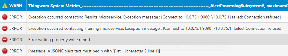

Can you provide me a screenshot of any errors in Application Log and the Script Log?
ALso, have you reviewed this article, checking if the config connections IPs still match?
https://www.ptc.com/en/support/article?n=CS273969
Neel
These are the errors in Application Log and no errors in Script Log
I don't know whether the analytics.server.ip and microservices.server point to the right ip address and port

The Logs confirm the IPs got changed, and that you need to adjust the,.
You can see what IP is being issued by using the Docker list command for the containers.
Please try the article provided above as a possible solution to your problem.

At this time the only recommended action I can suggest is a uninstall and re-install.
Neel
Hello
I have tried much times, but everytime I re-installed,the next day it would occur again.
CCI_9
How are you stopping the Containers when you end for the day?
Are you just shutting down your computer, or are you using the Stop Utility that included in the Start Menu to stop ATE?
Neel
Hello
I just shutting down my computer,dose it matter?
CCI_9
That may be causing improper shutdown of the containers.
Its highly recommended that you use the Analytics Shutdown utility prior to turning off your system.
It has been known to cause problems with the application in what we call violent shutdowns, which can corrupt containers or our microservices in the native installation.
