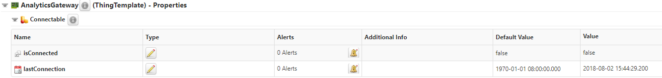

AnalyticsGateway's properties - isConnected always shows false

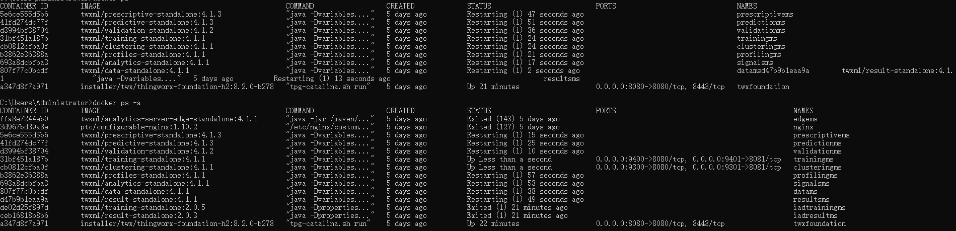

你好
我安装ATE的那天,我可以正常使用它,但它在第二天不能工作。
到期日期已更改。
这是命令“docker ps”和  “docker ps -a”的结果

Sorry, I made a mistake
On the day I installed ATE, I could use it normally, but it could not work on the second day.
The expiration date has been changed.
here is the result of command"docker ps" and "docker ps -a"

I don't know whether the   analytics.server.ip   and  microservices.server  point to the right ip address and port
CCI_9
nsampat
(To:CCi_9)
The Logs confirm the IPs got changed, and that you need to adjust the,.
You can see what IP is being issued by using the Docker list command for the containers.
Please try the article provided above as a possible solution to your problem.

Hello
I can't find  what ip is being issued by using command "docker  ps" and "docker  ps -a"
thanks

ARe you able to log into Builder and check the settings tab?
Does the Analytics Gateway show in the drop down menu there?
If it does, can you remove it, then re-add it, verify, then save?
Neel
CCi_9
11-Garnet
(To:nsampat)
Hello
I have tried, but it still shows false
CCI_9

How are you stopping the Containers when you end for the day?
Are you just shutting down your computer, or are you using the Stop Utility that included in the Start Menu to stop ATE?
Neel
CCi_9
11-Garnet
(To:nsampat)
Hello
I just shutting down my computer,dose it matter?
CCI_9
nsampat
(To:CCi_9)
That may be causing improper shutdown of the containers.
Its highly recommended that you use the Analytics Shutdown utility prior to turning off your system.
It has been known to cause problems with the application in what we call violent shutdowns, which can corrupt containers or our microservices in the native installation.
- Neel
