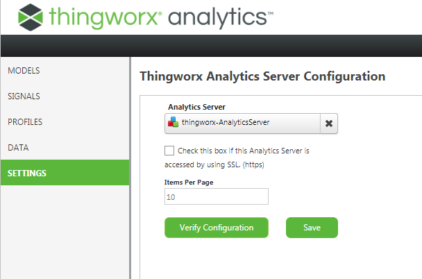

ARe you able to log into Builder and check the settings tab?
Does the Analytics Gateway show in the drop down menu there?
If it does, can you remove it, then re-add it, verify, then save?

(To:nsampat)
Hello
I have tried, but it still shows false

(To:CCi_9)
Can you provide a screenshot of the Settings Tab in Builder?
I am referring to this screen:
Neel

(To:nsampat)
Hello
This is the screenshot1533737152(1).pngthanks
