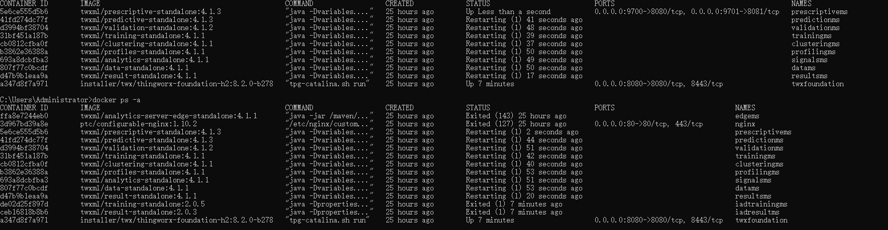

你好
我安装ATE的那天,我可以正常使用它,但它在第二天不能工作。
到期日期已更改。
这是命令“docker ps”和  “docker ps -a”的结果
1533285906(1)
谢谢

Sorry, I made a mistake
On the day I installed ATE, I could use it normally, but it could not work on the second day.
The expiration date has been changed.
here is the result of command"docker ps" and "docker ps -a"
1533285906(1)

Hello
I can't find  what ip is being issued by using command "docker  ps" and "docker  ps -a"
thanks

How are you stopping the Containers when you end for the day?
Are you just shutting down your computer, or are you using the Stop Utility that included in the Start Menu to stop ATE?
Neel
CCi_9
11-Garnet
(To:nsampat)
Hello
I just shutting down my computer,dose it matter?
CCI_9
nsampat
(To:CCi_9)
That may be causing improper shutdown of the containers.
Its highly recommended that you use the Analytics Shutdown utility prior to turning off your system.
It has been known to cause problems with the application in what we call violent shutdowns, which can corrupt containers or our microservices in the native installation.
- Neel
