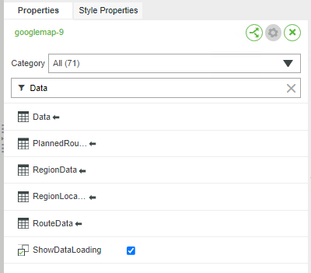

Hi, I want to use the geometry and drawing libraries from google maps, I have updated the metadata.xml file adding libraries=geometry,drawing, but I don't get the corresponding options in the map widget, is it necessary to make more changes in the code for it to work properly?

@AC_9552412 ,
From the screen capture you added code to "googlemap.ide.js".
There should also be code added to "googlemap.runtime.js" which makes the approate updates.
The updates include adding the option "drawingControl: true," to options when the item is checked.
You also added the drawing library:
googleMapsConnectionString = _invoker.result.rows[0].GetGoogleMapsConnectionString + "&libraries=drawing";
When defining an instance of the Google Map you need to create an instance of the map object. This looks like
 = new google.maps.Map(document.getElementById("map"),
from the Google Maps Documentation. When reviewing the "googlemap.runtime.js" we find:
thisWidget.map = new google.maps.Map(document.getElementById(thisWidget.jqElementId), options);

hi @PEHOWE ,
I want to show all drawing options

@AC_9552412
Is this the tool bar you are trying to add?
Can you share how you changed the configuration to add the libraries?
That is the bar I want to add
Hi @PEHOWE,
All the options you see in your image are displayed but this option should be displayed, which is the one I'm missing.
