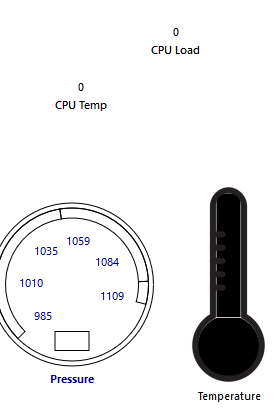

The user can see the mashup in composer and can view the mashup. But not the data.
This is what the user is supposed to see.
This is what the user sees.

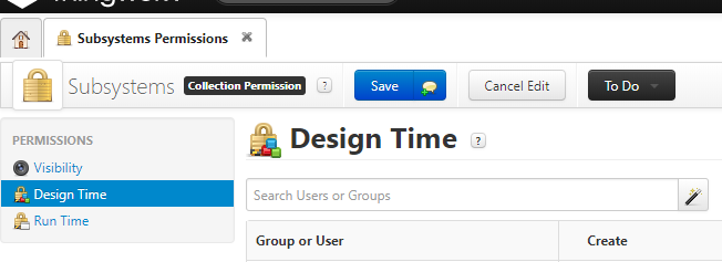

I thought is was permissions on the value stream/ the thing/ thingtemplate / thing shape so in an effort to trace the problem I added the group to each of these entities to see if that would fix it.
Still the situation does not change.

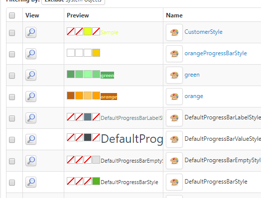

When adding my Org to the Style definitions I did see this.
As part of the administrators group this is what I see in composer
As the user this is what i see.
I have added the group and org but still no change.
